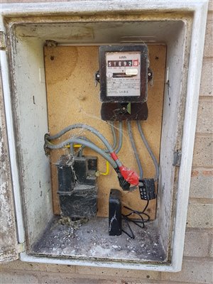

  • Part of the EICR I have just completed, there's several items to note.
    Edit- 60 amp DNO fuse.
  • Sparkingchip:
    House purchasers EICR if you think that has a bearing.
  • Now that’s something new. The question is why would anyone do that to meter tails. Lots of inner insulation showing and the seal missing on the fuse carrier is well.
