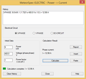

    If you use convenient calculation tools, the task is very simple.
    Load = 3 Phase Immersion Element
    P = 9kW
    Line voltage (phase-phase) = 400V
    Cos phi = 1.0
    Phase current = 12.99 A

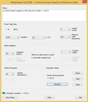

    The current carrying capacity depends on the installation conditions.
    Cable selected = Cu 2.5mm2  3p+N,
    Protection = MCB 3x16A
    and calculation report:
