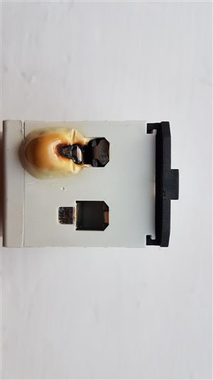

  • I'm about to type up some landlords EICRs, the one job I did the repairs whilst I was there.
    The flats were only converted five years ago and they have MK consumer units with steel enclosures, bought as preassembled kits.
    I had to replace one of the two RCDs. This only had the busbar in without any additional cables,  so you are right to be cautious.
    I had to straighten the busbar as it had a significant bend in it, this is a 63A and I replaced it with a new 80A I had on my van.
  • Although only five years old this installation needed remedial work some of which was because it was obviously never tested.
  • It's easy being an electrician,  all you have to do is join three wires together.
    I spent several hours fault finding and correcting terminations along with other bad workmanship.
    And of course doing a landlords EICR in a five year old flat is just a box ticking exercise!
