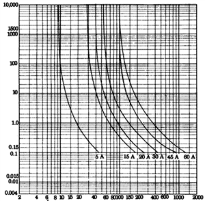

    Anyway: the following is about the semi-enclosed fuses, which I and Graham seem to have assumed would do worse than many other devices. Is that justified...?
    I did, finally, find the text of BS3036. In it I see no requirement on let-through, nor on the detail of the time/current curve. It requires a fusing factor not greater than 2. And that the manufacturer shall provide a time/current plot over a range at least including 5% above the minimum fusing current and the 0.5 s fusing current. It's a far less tight specification than is found in standards for modern cartridge fuses, which typically require a t/I curve to fit between specified points, and total and pre-arcing let-through to be within some limits. Of course, a manufacturer could provide further specifications for semi-enclosed fuses, such as let-through versus prospective current, but I haven't found any example.
    Fig 3A2 in BS7671 mentions 'maximum' disconnection times. The times given actually look rather low even for just the melting time. BS7671 Table 533.1 shows 0.85 mm diameter tinned copper for a 30 A fuse, whereas I need to come down to about 0.80 mm copper if calculating adibatic melting of the wire in 0.1 s with 450 A. Perhaps the tinning is expected to be thicker than the few-micron sizes I saw in references about other tinned copper.
    The time that BS3036 wants used in manufacturers' time/current plots is the pre-arcing time. An appendix in BS3036 gives an example oscillogram from operation on 'moderate prospective current', in which arcing continues for 2 cycles with little reduction in current. So it seems the arcing period shouldn't be considered negligible in its effect on duration and let-through when one comes into the hundreds of amps range (which is the range I assume the plot means: low enough to have several cycles for melting, but high enough to have significant arcing). This fits with what I'd expected for semi-enclosed fuse operation in short circuits. Yes - melting times of fuses tend to a constant let-through at high currents. And good quality HRC fuses don't add much arcing let-through at prospective currents so low (by their standards) as 1 kA. But a couple of cycles of arcing of a semi-enclosed fuse at 1 kA could mean another 40 000 A2s just from the time of arcing. I'd risk a guess that the arcing period would not get shorter for higher current. If we move towards the 6 kA case mentioned earlier, the BS3036 fuses would be out of their depth, and presumably the let-through could be the value for the upstream cutout. In contrast, a good cartridge fuse or modern MCB will typically cut the current in a half cycle or less. This is partly why I'd (still) expect the semi-enclosed fuse to have high let-through at currents such as 1 kA. Also, because its element doesn't have the carefully formed restrictions of a cartridge fuse, I'd expect it to be a good deal slower at melting when coming up to the 1 kA level. Unfortunately, there don't seem to be specifications for BS3036 fuses at these higher currents that give times <0.1 s, and even the BS7671 value for 0.1 s may be rather low and not include arcing time.
    As you'll see, this is mainly curiosity about how BS3036 fuses really behave, as an aside to the wall warts.  Having become used to diazed fuses, which are about 5 for a pound, always rated for prospective 50 kA, and with a nice low fusing factor like 1.45, I'm a bit suspicious of the venerable semi-enclosed things.

    The fact the the BS1361 (or BS88-3) company fuse does not normally blow (even a 60A one) against a BS3036 30A, allows us to put another upper bound on the let-through energy of the old hot-wire fuse - even if it has been rewired in paperclip, the company fuse imposes an upper bound.

    The upper bound set by a service fuse can be a bit misleading, but it should be good for currents in the several kA level and up.  If we take, e.g. this bussman service fuse spec we'd find that the melting (pre-arcing) I2t for their 60 A service fuse is about half of what Andy and Graham have shown as lower bounds for the 30 A BS3036 based on t/I curves.  This makes sense because the values are for different timescales, and the cartridge fuse varies in I2t between these timescales.  The quoted I2t is for short times such as 10 ms. If one uses t/I curves from the same spec to calculate I2t for longer times, the result increases to about 4 times as much at 200 ms. The restrictions (necks) in a cartridge fuse element allow the bend of the t/I curve at short times to be designed. A fast fuse (semiconductor) has short but thin restrictions that can melt very quickly at one current, but can conduct their heat away to the surrounding element at rather lower current, whereas a general-purpose one has thicker, longer restrictions. Meanwhile, the simple cylindrical wire of a BS3036 fuse gives no control over the t/I curve for times at which heat transfer from the element can be neglected, which for a 30 A size would be times up to several hundred milliseconds: over this range the melting needs roughly constant I2t.  Cartridge fuses overtake the simple fuses in speed at the higher currents, because the shortness of their restrictions means that one has to come down to only milliseconds or tens of milliseconds before the melting I2t becomes roughly constant.  As long as most faults that pit a smaller BS3036 against a bigger cartridge fuse have rather low current, e.g. 1 kA or 500 A due to typical impedances of source, cable and possibly fault, the bigger fuse survives. But at higher current there comes a point where the curves will cross unless the cartridge fuse is much bigger or is designed for slow blowing.
