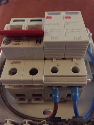

Hi all,
I bought one of these for the first time today for a job I have coming up. I was suprised when I opened it up to find the SPD linked to the isolator by just 2.5mm wires, as these are the factory connection I guess this is the norm but I was suprised all the same! Why so small? I was expecting a copper busbar!

  • When operating normally, SPDs only handle brief transients - the sort you get from e.g. a lighting strike near the distibution network somewhere. So although a significant current may flow through the SPD, the total energy passed is small and the cable won't overheat. If the transient is too long, the fusible element built into the SPD will open, again before the wire has overheated. Finally, the fact the OCPD in the SPD is after the cable is probably covered by [433.2.2] and/or [434.2.1]
    (All the above is speculation on my part.)
  • Humm 2.5mm² does seem a bit smaller than I would have expected - hardly in the spirit of 534.4.10 (although presumably these will be covered by the product standard rather than BS 7671). Maybe it says something about the size of surge than the manufacturers think it'll be able t cope with.  It even seems a bit thin for ordinary fault protection given that the upstream protective device is likely to be the DNO's fuse at anything up to 100A.

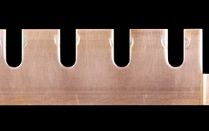

  • I have 2 Wylex SPD REC 2 with SPDs and both came with bus bar links.
  • John Peckham:
    Hmm thats strange.. maybe I have got an old stock one? Or maybe a newer version...

  • That does look  bit cheap - however, as the calculation above shows, it will still pass the test spec of the 8us/20us  at 20kA, probably with a bit in hand. I imagine there has been a design review and a decision to do some 'value engineering' and save a few pence.
    In terms of SPD function it would be better if the links were short and fat, and routed together in a way that their magnetic fields cancelled (*), as this would give the lowest overshoot voltage during the surge. (well not quite, the lowest would be if the mains came in as a piar to the SPD, and then out again from the SPD, but a short 'T branch' is unavoidable in most designs.)
    Looking at that, is the SPD on the incoming or outgoing side of the switch ? - I'd expect out going and I presume this is in a box on its own, not in a CU where the bus bar is at the bottom.

  • Yes, it is on the outgoing side and is a separate unit on its own outside of the consumer unit.
    Thanks for all all the information regarding SPDs, it's something I'm fairly new to  !
  • That’s a consumer unit main switch, not a REC main switch ?
