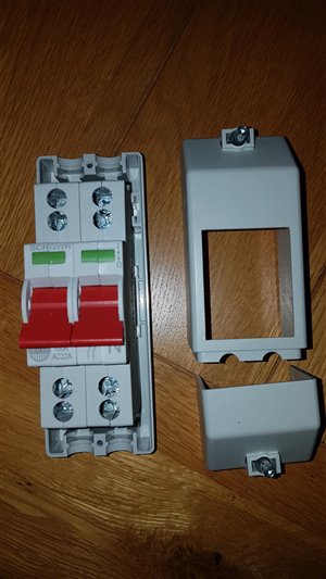

I bought one of these for the first time today for a job I have coming up. I was suprised when I opened it up to find the SPD linked to the isolator by just 2.5mm wires, as these are the factory connection I guess this is the norm but I was suprised all the same! Why so small? I was expecting a copper busbar!

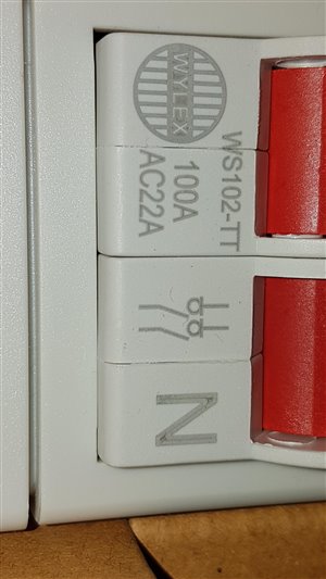

  • They are both labelled as an AC22A, but the one with the the SPD is a WS102 which is a consumer unit main switch with a slot to accommodate a balcony busbar allowing it to to secured under output terminals screw heads, whereas the isolator in my photo is the “real” REC switch a WS102-TT with double screw terminals that tighten plates down onto the conductor rather than being a cage clamp terminal.
    I presume the TT in the code refers to it being double pole and suitable for a TT earthed installation. If you pay particular attention you will note the main switch with the SPD is marked as a single pole isolator, despite being double pole, whereas the isolator I have posted a picture of is labelled as a double pole isolator. Though in both photos the switch is down, so that’s not obvious unless you look carefully.
    I presume the SPD unit has been supplied with a consumer unit main switch rather than a REC isolator on purpose.

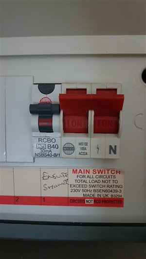

  • Single pole isolator double pole consumer unit switch with balcony busbar slot.
    The double pole REC isolator without the balcony busbar slot.

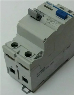

  • Same with Hager.
    https://electricalcontractingnews.com/news/hagers-ask-the-expert-understanding-surge-protection/
  • Because the Hager main switch has slots that allow fork crimps to be secured under the output terminal screw heads.
    Like this RCD.
