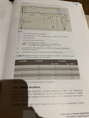

MrJack96:
So that means the external resistance between the two earth electrodes would have to be pretty small? I know I’m a TT system we have higher touch voltages due to this issue of the earth being a high resistance
Not necessarily. If the Neutral breaks, all the load current tries to go down the extraneous-conductive-parts back to the transformer. If this is resistance is about 100 Ohms, about 10 % of the current that would flow, flows through a person touching either exposed-conductive-parts, or extraneous-conductive-parts connected to the installation. Within the influence of the equipotential zone, the effects may be less. If the resistance is 1000 ohms, half of the load current will try to travel back through the person - certainly the equivalent will be a full Uo equivalent shock with no automatic disconnection.
In TT systems, touch voltages within the influence of the main protective bonding are often far less than in TN systems, but outdoors, they approach Uo - this happens only in an earth fault, though, and is disconnected in a time according to Chapter 41. With a broken PEN, the only fault is the broken PEN - there is no fault in the installation - and not even an RCD will protect you.
