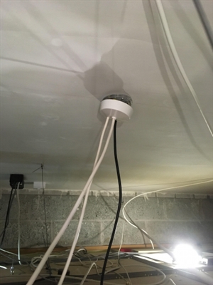

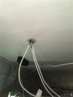

  • but then without the ceiling  you cannot pretend to be using the fabric of the building as the enclosure, which sort of you are allowed to do.
    526.5
    Every termination and joint in a live conductor or a PEN conductor shall be made within one of the
    following or a combination thereof:
    (i) A suitable accessory complyi ng with the appropriate product standard
    (ii) An equipment enclosure complying with the appropriate product standard
    (iii) An enclosure partially formed or completed with building material which is non-combustible when tested to
    BS 476-4.
    I imagine that  a suspended ceiling  is an enclosure made of  building material to some folk... Not  sure how many would survive the 20min red hot test though. I suspect that clause is really aimed at bricks and plaster.
