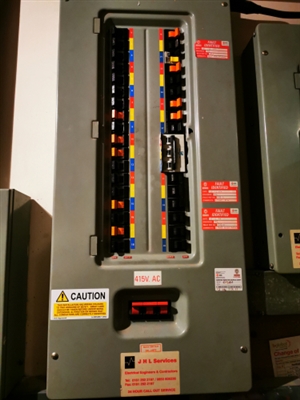

​​I was hoping I could glean some knowledge from you bright sparks.
I have a very old (and should be illegal) Federal Pacific 3 Phase Board that I am updating. It currently has 36 ways (with 2 Triple Pole and 30 Single Pole Breakers) with 3P 100a Disconnector.
There aren't many Boards that can fit that amount of outgoing ways, but I've find Europa Components do one.
Is it a case of switching old SP Breaker for new SP Breaker, and similarly for 3P Breaker.
I've attached a picture to hopefully help with your advice.

    Hello, why are you updating the board? Are you adding R.C.B.O.s? Check compatibility before buying any new components. Why do you think that the board should be classed as "illegal"? Is it because one triple pole breaker seems to be of a different make to the board itself?

  • Yours is a 12 way tpn board, plenty available that size and bigger.
  • generally yes, swapping one breaker for another is straightforward. BUT be aware that while the DIN rail profile is standard between makers almost XXX all else is, so that breakers from another maker, or even the same maker but a different series may or may not fit - in the sense of not making good contact to the central busbars, and or the lid wont go back on. At this stage you are probably less worried about the warranty, but you do not want to be trying things hopefully to see if they fit.
    Are you replacing the board or adding to it.
    a 12way 3 phase board is a fairly standard part.
    larger are also readily available
    from more than one maker if you wanted to leave expansion room or add SPDs etc.
    Does that one have the insulated shrouding over the incomer internally ? If not even when the main switch is off there is a considerable amount of live metal you could drop your tools or a loose wire end onto.
    Have you had a look inside ? - some are very neat, and cables all clearly labelled and marshalled, others erupt like so much spring loaded spaghetti.
    I suggest you peek inside and scope the job and see what parts are available and what the issues may be before you start in earnest. Also  make sure you know where the supply switches off.
    I presume from your  query you have not done much 3 phase, as this is bread and butter to those who do, but ideally you need to start with someone beside you who has.
    Mike.
  • NoviceLearner:
    That looks like a Federal Electric Stablok board. I agree with everything that Zoomup says and would be interested to have your answers, although I doubt whether another manufacturer's MCB would fit properly. Perhaps it does not?
    The question above seems a bit odd. Bear in mind that you will be swapping, let's say, a type 1 30 A MCB with a B32 one.

    As far as my research has led me, the Federal Pacific board is atrocious, prone to overheating and burning. The system itself hasn't been tested since 2006, and could really do with updating.
    The triple pole is an updated version of the other FPE Breakers.

  • The biggest problem with this board, is someone has butchered it to fit a different make of mcb at way 10. You won’t know how safely this has been done until you take the cover off. The door is also missing.

  • its the American ones that tend to catch fire, I don't know of any UK scandal around them
    you can get RCBOs for them.
    I would be concerned that it contains an incorrect breaker though, and even swapping it with the right sort might not be great if its damaged the busbar
    its obviously thirty odd years old too

    Let's get this clear. Are you proposing to change the board yourself, or are you going to get an electrician to do it for you?
    Being old isn't an issue; but that white MCB might be - it does not appear to fit properly.
    Inspection will reveal whether or not there has been any overheating.
    There appear to be 4 test labels so presumably there has not been a problem in the past.
