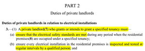

  • Hi Graham, I’d like to agree with you with regards to the PRS Regulations, only I think that another, much more onerous interpretation may be easily adopted.  I.e. that the installation is required to meet the requirements of BS 7671:2018.
    That interpretation is one which a hypothetical (or real!) prosecution could quite reasonably and easily adopt.
    See Regulation 3(1)(a) of Part 2 (excerpt provided below for clarity), which says “ensure that the electrical safety standards are met. . .”
    “Electrical safety standards” are clearly defined in Part 1 as meaning those of BS 7671:2018.
    I think we all would agree that the wording of the PRS Regulations is poor and ill thought out, but I just wanted to make the point that simply testing in accordance with BS 7671:2018 will likely not be good enough given the wording of this statutory document.  Anyone choosing to interpret the statutory document according to what they think it should have said, is taking quite a risk.
