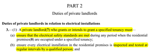

    Hi Graham, I’d like to agree with you with regards to the PRS Regulations, only I think that another, much more onerous interpretation may be easily adopted.  I.e. that the installation is required to meet the requirements of BS 7671:2018.
    That interpretation is one which a hypothetical (or real!) prosecution could quite reasonably and easily adopt.
    See Regulation 3(1)(a) of Part 2 (excerpt provided below for clarity), which says “ensure that the electrical safety standards are met. . .”
    “Electrical safety standards” are clearly defined in Part 1 as meaning those of BS 7671:2018.
    I think we all would agree that the wording of the PRS Regulations is poor and ill thought out, but I just wanted to make the point that simply testing in accordance with BS 7671:2018 will likely not be good enough given the wording of this statutory document.  Anyone choosing to interpret the statutory document according to what they think it should have said, is taking quite a risk.

    So if you built a house today, which had grid connected PV, you would apply BS 7671:2008 throughout the whole installation?  Not BS 7671:2018?  I guess you could then use a plastic consumer unit.  Or would you rather understand that ESQCR was written when BS 7671:2018 did not exist, and so could not have cited it.  I don't think that this gives us the right to decide that the most applicable standard is one that predates the one that is explicitly stated.  When the 19th Edition arrives, we may have a similar scenario with the PRS regulations but in that case, we will still be requiring compliance to the 18th, or perhaps the 19th but not previous editions.
