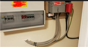

  • Where is the supply fuse and electric meter in relation to the Flat?
    There is no gas you say, so is there off peak electric for heating and hot water or electric boiler and a 2nd consumer unit or maybe an extra large consumer unit with two sets of tails into it?
  • Former Community Member
    0 Former Community Member
    Alcomax:
    this is what's inside the cupboard by the front door.  No gas, and night storage heaters and electric water heater. Economy7 electric.
  • How can the RCD and main switch be swapped around in a Crabtree consumer unit?
    I have seen it done in other makes, but not in a Crabtree.
    There is another row of RCDs above that aren't in the photo. Not sure if that makes a difference??
  • Yes, it does.
    Presumably the main switch and the three MCBs on the righthand side are the storage heaters and possibly an immersion heater?
  • That just answered my next question; it is a double decker consumer unit, I thought that cannot be enough circuits from the photo.
    So a red head and there will be a Ryfield somewhere in a common area. Something like this was designed and managed as a whole and so it would be very unusual for main protective bonding and if  and where its is required to not have been considered at build stage.
    As Sparking said the main water into the building will be PVC if it was a new build in 2005.   What happens after this PVC and how it goes to Flats in what material influences a few things, but that would have been obvious when it was being wired for the first time. As there is no gas service there would have been a fairly simple test to establish if the copper coming to the stop tap was extraneous or not.
    Unfortunately this all does not help as remedial work has been completed.
