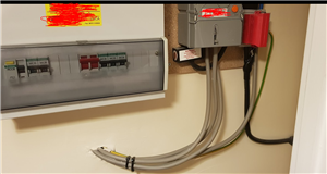

    Alcomax:
    Where is the supply fuse and electric meter in relation to the Flat?
    There is no gas you say, so is there off peak electric for heating and hot water or electric boiler and a 2nd consumer unit or maybe an extra large consumer unit with two sets of tails into it?
    this is what's inside the cupboard by the front door.  No gas, and night storage heaters and electric water heater. Economy7 electric.
    That's horrid! I like the fact that the tails have been tied together (although one appears to have slipped) but why not bring them into the bottom of the CU? Grommets would suffice on the bottom surface; glands would be even better.

    Chris Pearson:
    JoeB:
    Alcomax:
    Yeah it's not pretty is it..

  • So basically is the fan wall or ceiling mounted? Is it actually in zone 2 if ceiling mounted. If it is in zone 2 is it of the correct IP rating for the zone. Would be good to see a photo of the whole board.
  • I see it’s ceiling mounted so highly unlikely to be in zone 2
  • Humm - that supply looks suspiciously like it might be CNE to the head (alternatively it might be split-con with L & N in one leg of the trouser and PE in the other, but I'm not convinced). CNE within a building isn't what the DNOs like to do these days (especially as they usually pass the buck to a fictional BNO) but was common enough a few years ago. The original design might then  have considered the block to consist of mutiple distinct installations with separate DNO supplies for each flat - and hence would have required main bonding (if necessary) within each flat (like a terrace of houses). If the water pipe is in contact with class I equipment in another installation (e.g. the pump - presumably on the landlord's supply) then it would be classed as an extraneous-conductive-part as far as the flat was concerned (even if the water originally came out of the ground in plastic). Just a thought...
