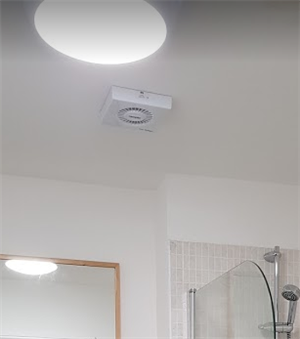

    Big thanks to Chris for taking the time to come and view the installation - I really appreciate the time and effort you've invested in this for me, thank you.
    This evening I decided to purchase an electronic copy of the 18th edition wiring regulation and have been working through the points on the EICR report referencing them back against the 18th edition.
    Now I'm certainly not an electrician (I'm a financial software developer with a degree in experimental Physics so not a total thickie!) but with help of what Chris said during his site visit, and the 18th edition to refer to, I believe I can now see the blatant (deliberate?) errors in the report.
    For those wondering, here's a photo showing the location of the ceiling fan - clearly the electrician who conducted the test has a very different understanding of bathroom zones to the rest of us, but he was perfectly happy to install that mains voltage light fitting at the same time as insisting the extractor fan had to be ultra-low voltage...
  • You would have hoped that we all knew the zones, unfortunately if you look at any light fitting instructions there will be the magical basin zone. Hate to think how that happened but your be surprised how many believe it’s in the regulations. Also was the water main earth required?
  • I think that is probably because the regulations say "bath or shower basin", and this probably confuses anyone without certain analysis skills, particularly those who work for manufacturers and write the "instructions".
