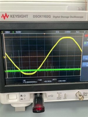

For several weeks now, there have been reports of multiple Monitors intermittently switching off and on again across 5 or 6 different PC users in an office of 20 PC users. Sometimes as little as twice a day but up to as often as15 times a day Apparently, this has led to multiple monitor leads no longer working and being replaced but the issue still remains.

What the scope did pick up though, was a voltage on the exposed metal casing at the bottom of the monitor at the rear (Where the DVI ports etc are) that spiked whenever the monitor was turned off via the fault.
Here's where it gets weird.... The PC users, prior to my involvement had set up a 100w lamp (Bayonet type) to see if it would flicker when the monitors turned off (which is doesn't) but in actual fact, when you turn the lamp on and off, it would throw huge spikes onto this metal casing at the back of the monitor! I measured up to 100V on the scope! It would also turn the monitor OFF/ON. The lamp has no earth connection as it is all plastic housing.
When I plugged the lamp into the sockets on the other side of the room (Separate ring circuit) it did make a slight reading on the scope when probing the same part of somebody else's monitor but nothing like the amplitude I was getting on the problem circuit. More like 5V rather than 100V and no monitor issues either.
I can only assume that the RCD isn't tripping because it is such a fast spike! However that does surprise me that it would still damage a lead!?

    I understand to use the "quote" now ? derp!... Here's a pic from someone else's Monitor but on the same ring. This person has had less issues than the others. This is with no flicking the lamp on/off so what you are seeing is just from about 12 people using their PC's...936e9103b6d1ec45dc68045f69b51ef6-original-10.jpg
  • Right Dave, what exactly is the fault with the HDMI to HDMI lead that has failed? Which pins are now not connected? The DVI.HDMI and VGA>something else are electronic so not much help, but a HDMI>HDMI is not if less than about 10 metres in length. You are claiming to have made one break, so what broke. Simple really. Spikes of this size are really not possible in the ways you are suggesting, unless something very unusual is wrong. If the other ring is different then you need to find out how, as you say it is to the same DB. There is something significant somewhere. This is not a simple EMC issue. You have not answered my questions either, how do the monitors "switch off", is it power, the PC or data?

  • Is there anything unusual on the supply side - e.g. a UPS or power factor correction (e.g. the automatic type that switches capacitors in and out of circuit as the perceived PF changes) - that a even a slight change in a load might be nudging between states?

    There is a power factor correction unit that i've had a quick look at but in all honesty, a quick check on the display which read 1.0 as you'd expect, and that was about as far as my knowledge could take me with that particular bit of kit ?
    One thing i'm looking at now, is what other items are on the same phase. The ring on the other side of the office is on L1 and the problem ring is on L2 along with most of the likely suspects that may or may not cause this type of issue. Things like plotters and printers for vinyl applications in a decals dept and lot's of aircon etc. I think the decals dept go home at 16:00 so i'm going to try and go through some process of elimination outside of the ring itself.
