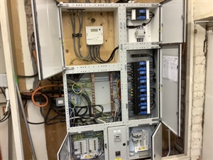

  • But were the missing bus-bar nuts the cause of over heating inside the U.P.S. itself?
    Information seems incomplete on that point - his electrician seemed to think that if they had been missing originally the thing would never have worked at all.
    It seemed that the manufacturer had been on site to investigate - so I suspect it was dismantled after the event and not quite all put back together before the video was made.
