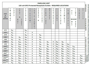

Does anyone know where I can find table 48A? I am reading of its existence, but don't know where to find it.
  • ProMbrooke:
    Right, but what has me perplexed are the lack of tables in part 7. Exception being medical locations however this should apply to all kitchens, bathrooms, laundry areas, garages, unfinished basements, exterior sockets, pool circuits and the like- anywhere skin conductivity is lowered typically through moisture or large earthed surfaces.
    Bonding and RCDs should not be the primary means to achieve protection in these areas. Rather a pyramid approach should be taken imo. Remote earth is impossible to avoid in all scenerios. RCDs have much higher failure rates compared to MCBs. Yet ADS remains the most simple, assured and reliable way of protecting life and property.
    Disconnection time may not be the answer, so that's why no tables.Where RCDs are specified, you're practically there already (0.04 s disconnection time OK for U0 230 V and your "Wet" table).
    In terms of other locations, there is a need to take into account other issues, such as the clothing and footwear people are likely to be wearing etc - which change the touch voltages and disconnection times also. See IEC TR 60479-5:2007. IEC60479 : 2007 Effects of current on human beings and livestock –. Part 5:Touch voltage threshold values for physiological effects

    Would these be for mainland Europe where bathrooms may not have supplemental bonding?
    I personally would not rely on bonding alone in wet locations, in particular exterior sockets where earth mat is not practical for a user.
    Roughly harmonized across Europe, minor differences as socket-outlets are permitted in Zone 1 etc. - RCD protection gets you to 0.04 s, so OK. A slightly more cautious approach, but there all the same.
    I don't really see an issue for "wet" or "humid" as we either apply bonding, or use RCD in the UK.
    Exterior locations are not classed as "wet" particularly in BS 7671. But your point is fair and definitely considered. RCD protection is used for outdoor socket-outlets and many items of outdoor equipment, so disconnection time is 0.04 s (Regulation 411.3.3). Larger circuits with Class I products, expect larger CPC and perhaps lower touch voltages ... and so on with that sort of thinking.
    I'm surprised regarding exterior sockets, but this may come from the UK having a CPC since the WWII. I'd go on a limb and say the UK has not had many accidents involving outdoor equipment hence not being classed as a wet location, at least this would be my guess.
    In the US where missing or no CPCs were common on metal tools, GFCIs were first required on outdoor receptacles before moving to bathrooms, garages, ect. The most injuries occured in outdoor locations.
