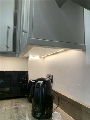

My friend has just had transformer boxes installed in her kitchen units. To me this looks strange. Does anyone know if this poses a problem as she has children in the house.

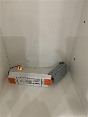

  • It looks a rather poor job to me.
    The slight risks include,
    1) Lack of fixings or supports for the presumed twin with earth cables entering the junction boxes. Repeated movement could result in loose connections.
    2) Risk of the transformer or junction boxes being broken by heavy items like cans of food, and live parts being exposed.
    3) Risk of fire if the transformers become covered with thermally insulating materials such a pile of dusters.
    Not great risks, but still not right.
  • Is that the top of the cupboard or the bottom ?
    How are the lights turned on and off - is the transformer on all the time ? - I;d be interested at the quality of the attachment of the things it supplies and any switches that regularly get touched to operate it
    It looks a bit amateur but is probably not breaking the letter of any rules.
    It does not look well supported, I'd expect to see brackets or clips, screws and so forth, and to be able to give it a reasonable tug without it moving about.on the wiring, I suppose there may be concealed sticky pads, but even if there are, it would still count as  looking  a bit rough - which makes me wonder about the quality of the rest of the installation.
    Depending on the level of cupboard and what goes in it,  rather more mechanical protection may be advisable. A heavy strike with  a saucepan, or conductive liquids like spilt orange juice will not be deterred by the plastic covers on the terminals. (hence the top of the cupboard is often a better place for such things,) A cupboard of tea towels will not mechanically damage it, but smothering so it runs warm  is not good for the lifetime reliability
    If everyone is careful around it, it will last fine for years, and that may be the calculation. It will not survive rough treatment, depending on the users that may or may not be OK.

    The box and wires is at the bottom of a kitchen cupboard where children go into it regularly. To me it is hazardous and unusable for everyday kitchen items.The LED lights underneath the box are flashing on and off all the time too.3e18dab272fd2361a02a20f82f647ed5-huge-img_9607.jpg
  • It would be much better if the junction box (on the right) and the transformer were screwed down. A curious child might want to pull it out, which would not be a good idea. Ideally, it should be boxed in, which is a job for a chippy rather than a sparks.
  • That possibly gets the Badger of the Week award, rough as.
  • Well one of the most important of our regs is "Good workmanship and proper material" or some such words.
    It appears to break that one for a start.
    If done as a paid job then it is not of reasonable quality either.
    If I understand what I can see then it is a terrible job more fitting to a third rate, third world banana republic.
  • I think it's a very poor job!
    Where has he picked the power up from???
    Needs boxing, at least - with some form of vent, and fixed properly!
  • Where did he stable his horse?
    Lets hope it was a cheap job.......
  • 1) Lack of fixings or supports for the presumed twin with earth cables entering the junction boxes. Repeated movement could result in loose connections.
    Is that a Wago Box in the picture - if so it might have in-built cable restraints (like https://www.screwfix.com/p/wago-junction-box/7355F).
    I agree it's horrible job though. If you have to have something like that it would be a little better on top of the cabinet (although that's ideal either as that
    sometimes gets used for storage too).
  • Looks like a Wagobox Light to me, in which case Andy is correct. That assumes, of course, that the wee black restraints are all present and correct.
