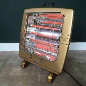

  • Radiation to heat only the individual, and not wasted on the building is very efficient in terms of comfort per watt. Obviously microwaves would be better, but there are health and safety issues with that. But it goes off  instantly and does nothing to dry the room or dispel mould.
    Personally, like their grown up relative the radiant bar heater, I rather like them.
    Talking of radiant bar heaters,  at  a push this type, with the exposed hot wire, allows you to run 110V radio kit from 240V with just a hose clip. You'd have to take the guard off, and this 3kW one is too much for a 5 A lighting cct.
