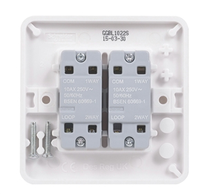

I am going to recommend  a certain make of light switches to all D.I.Yers. The make starts with an “S”.
They are just great for causing confusion, especially the two way type as the terminals are not traditionally positioned with the common at the point of a triangle and the L1 and L2 together opposite. Also the loop terminal confuses 'em luvverly. I got a load of work today when the householder had wired up some “S” light switches wrongly. GGGGGGGGGGGGrrrrrrrrrrrrrrrreat as that tiger used to say in the breakfast cereal commercial.

  • I see what you mean. ?
  • I too have not seen any switch plate like this before. The remedy would be to use a continuity/Ohmmeter to check what each terminal does before making the connection

  • At first glance, one might assume that the loop terminals are connected, but on closer inspection, no. That is a pity because if they were, it would make borrowing a neutral at the top of the stairs so much easier. ?
  • Although, I havent seen these switches before. IMHO a “Competant” electrical technician wouldnt have any trouble reading the manufacturers instructions/wiring diagram first before undertaking any electrical connections!! I would presume there is a little bit of paper explaining each terminal and its purpose on that paperwork.

  • So there we are, working in a dim light on a wall switch. The lighting is off 'cos we are working on a wall switch. We have read the installation instructions and have installed thousands of light switches over the years, one way, two way and intermediated switches. We have short wires from the wall box to the switch terminals which does not help the installation, and sometimes we have to work “mirror image” as we can not see the terminals directly. We get used to the terminal positions, then a new design comes out. It takes time to adjust, even for “competent” electricians. Normally we connect up as "second nature" if all light switches follow the same terminal layout, we can even do it correctly in the dim light available or even blind by feel only.

  • The switch featured looks reasonably easy to wire by anyone who can understand the simple markings, and presuming that working space and lighting are acceptable.
    The problems will come from not just from from DIYers but also from so called electricians who have no real understanding of electrical circuits and can only replace a switch or other component by exactly replicating the existing connections.
    I.E. remove wire from top left terminal of old part and insert in top left terminal of new part, repeat with other wires. If the new part has a different number or arrangement of terminals then it all goes wrong.

  • Am I the only one who knows how to use the ‘beep’ continuity range on the meter when faced with any kind of switch with non-standard markings or for some reason unreadable  such as reading round a corner?

    I expect Mike that you are not the only professional trained and thinking installer that has a test meter with a continuity beep facility. But do the amateur D.I.Yers? I have no problem with the aforementioned light switches, but it adds additional time to doing a job if the terminal layout is non traditional. For years a four terminal light switch was always an intermediate switch or a double pole switch. I also find that I have to be careful with switched fused connection units where the terminal arrangement varies in position from make to make and the markings are provided in small letters or signs.
    What beep would I get if I connect one test lead to the Loop terminal and the other elsewhere? Would I then return the switch to the local D.I.Y. shed as being faulty?
