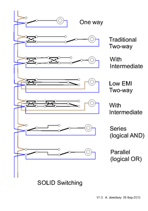

  • Use two way switches at one-way switched positions..
    L feed in to terminal L1.
    N feed in to terminal L2
    Light load (switched L) connected to Common  terminal
    Light N to terminal L2.
    L loop to next switch position from L1.
    N loop to next switch position from L2.
    P.S. This may also reduce L.E.D. light flickering when they are turned off.

    It is indeed important that the light switch is “break before make” but I have never seen one that is not. The TIME between breaking and making is not important.
    I have wired lights like this to prevent flickering of CFL or LED lamps when turned off.
    There is a rather dodgy way of wiring two way light switches that has been prohibited for decades, but may still be encountered. At each of the two switch positions, neutral is connected to either L1 or L2 and live is connected to other terminal. The lamp is connected between the two common terminals.
    Works fine but is potentialy dangerous since when the lamp is turned off there is a 50% chance that both sides of the lamp are live at line voltage.
    Popular for outdoor lights that are to be switched from the house and from an outbuilding. Saves cable since live and neutral are already both present at both switch locations, and only ONE extra wire is needed.
    Also popular in Europe where combined lighting and socket outlet circuits are common. Again it saves on material. Live and neutral are likely already present at each switch location for an adjacent socket outlet.  Only two lengths of SINGLE wire are needed to add a light with switch control from two locations.
