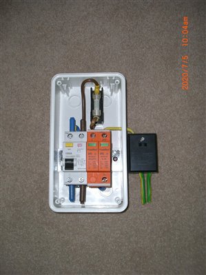

    The DNO is comfortable with this plastic Lewden 4/55ENC enclosure being installed in my meter cabinet. It contains a Fusebox RT1001002S 100a Time Delayed 100ma RCD with a Fusebox SPD2PT2 surge protection device (L-N & N-PE) in parallel alongside. The DNO equipment and meter will be protected against SPD (short circuit) failure by a Shawmut Mersen FR1 OAM40V32 fuse.  This lot will be installed for me when my CU is upgraded to 18th Edition metal ~ post Covid.
