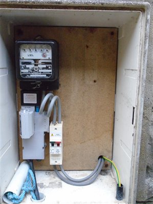

  • To be absolutely clear a photo of the DNO intake and the earth terminal would help.
    If the earth rod is connected to the DNO earth terminal on their intake it is almost certainly the property of the DNO and the supply is TN-C-S.
    If there’s no earth connection to the DNO intake and cable at all with the rod being connected to a completely separate MET then it’s TT.
    If it’s TT then the consumer unit probably should have a RCD main switch or there should be an upfront RCD, but the earthing will be okay.
    If it is TN-C-S it is probably worth converting it to TT, but there’s then there is how to maintain separation from the DNO earth rod to consider.

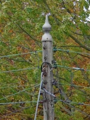

    These images show what things look like.  My supply is taken from the top and bottom conductors ~ L1 & L3?  ~ my neighbours variously connect (left) to L1 & L2 and (right) to L2 & L3 ~ so nicely balanced.  There is no connection between the earth conductor passing through my meter cupboard and the new DNO head.
    I don’t know whether what I see as neutral in my CU is connected to the top wire, the one always closest to any cumulo-nimbus cloud, or whether it is the other way round. In the past lightning has ‘cooked' a modem, but that strike probably hit the telephone line.
  • There is no connection between the earth conductor passing through my meter cupboard and the new DNO head.
    Looks like TT to me (especially if that G/Y goes just to a local rod and nothing else).
    It would be far more usual to connect each (single phase) customer between one L and N - and N is usually at the bottom (as it's the least hazardous and most likely to be touched by ladders, poles, etc) … although it does look like that might have been reversed for that 3-wire feed going off at an angle to the left.
  • Indeed it does look like a TT installation now that we can see the images. I came across an installation in the middle of nowhere in the countryside that was TT earthed. The owner said that they could not have a P.M.E. earthing terminal because the overheads were too long and Ze was too high, so TT earthing had to be used. The image overheads are likely to be in an impoverished area or very rural neglected area, as they are bare and old. Upgrading required.

  • Your supply is TT, but I suspect the overheads may be TNS.
    Are you in South Wales?
  • Sparkingchip:
    It says North Eastern on the meter, the whole setup hardly looks fit for purpose.
