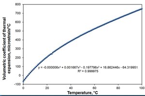

  • As regular readers on here know I like rules of thumb that allow a quick decision of ‘its OK’ or ‘it needs checking properly’.
    I am not a plumber, but for a quick look and see,  for the expansion vessel  on the water heater, a good start is expecting an expansion volume of about 10% of the volume of the heated water, rounding up,  rather than rounding down,  to the nearest catalogue size vessel available if you are replacing.
    This over estimates if the incoming cold supply pressure is low, and underestimates if it is already at the high limit.
     So  a 2 liter expansion tank ought to handle anything a 20 litre or less water heater can throw at it. Less volume may be OK, but it depends how much over-pressure can be absorbed by stretching things that do not really appreciate it, such as making taps drip and forcing water back up the street main.
    Mike.
    PS
    for heating the text book formula is
    Vexp = V_system *e/(1-p1/p2)
    where p1/p2 is the ratio of the cold to hot pressure,  perhaps 0.7- 0.8
    a moments thought shows this also has to be an approximation.
    relative to 25 °C
    Expansion Factor ‘e’
    Temperature °C
    0.0324
    85
    0.0359
    90
    0.0396
    95
    0.0434
    100
    edit
    (reference )
    Actually to do the sums properly,  note the expansion of water is highly non-linear with temperature, the rate (fraction of extra volume per degree rise is about 3 times higher approaching boiling, than it is at room temp, less as it gets colder, while it inverts at 4°C and stops shrinking starts to expand going colder,  an effect that increases sharply as freezing commences)
    In terms of volume change in litres per litre per °C,
    Volumetric Temperature Coefficient
     - β - for water vs temp.
    • water at 0°C -0.000050 (1/°C)
    • water at 4°C: 0           (1/°C)  Minimum volume
    • water at 10°C: 0.000088 (1/°C)
    • water at 20°C: 0.000207 (1/°C)
    • water at 30°C: 0.000303 (1/°C)
    • water at 40°C: 0.000385 (1/°C)
    • water at 50°C: 0.000457 (1/°C)
    • water at 60°C: 0.000522 (1/°C)
    • water at 70°C: 0.000582 (1/°C)
    • water at 80°C: 0.000640 (1/°C)
    • water at 90°C: 0.000695 (1/°C)
    Or for those who like graphs (or indeed arbitrary curve fitting  with no good physical justification, other than ‘excel does it’ ) , - parts per million volume expansion per degree temperature rise up the side, vs temperature. (source
