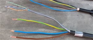

    And a picture No need to remove the jacket and screen of the data cable until well away from the main cores.
    If the standard thinks this construction is unsafe because of the risk that mains will end up on the data lines, the standard is probably not right. If it is a good idea for EMC over a long run, I am much less sure.
