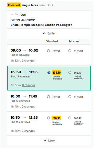

    I will tell you why this "public transport" idea does not work. I wanted to go by train from Bristol to London on 29th of January with my partner. I looked to book but the price is astronomical. We can go standing class for about £300 return, or first for only £700! I call it standing class because there are NO bookable seats! By car, it would cost me a small fraction of this, even with huge parking charges, recently about £70 per day in central London. Of course, I would need a fully charged car so could not trust this system above. Brunel would turn in his grave, and even I have difficulty not doing so, particularly as roads in Bristol have been closed for 2 years due to alleged "electrification", which will be slower than the HS125s we used to have (60 minutes door to door). This minor "upgrade" is taking longer than the original building of the line, so much for progress!

  • I will tell you why this "public transport" idea does not work. I wanted to go by train from Bristol to London on 29th of January with my partner. I looked to book but the price is astronomical. We can go standing class for about £300 return, or first for only £700!
    I've no idea who you asked about the fares but they seem to have got their decimal points in the wrong place. I've just looked at a well known on-line tail ticket site and both of you should be able to get to London on that date for less than £75. Probably less if you'd booked further in advance or could manage with a less civilised departure time. Return is usually less than two singles.
    and there are options to book seats on the next page too.
    I'd grant you that the rail ticketing system is rather a mess and very confusing to the casual traveller - traditional "walk on" fares have all but disappeared for long distance these days - the train companies much prefer you to book in advance and often operate an "airline" style ticket price system - i.e. the price varies very considerably depending on how many empty seats they think they're going to be left with. Walk-on prices are often pitched to encourage pre-booking, but anyone who can sell you a ticket should really offer you the cheapest available.
    But all that is a consequence of politics and marketing - rather than any fault in the underlying transport technology - and could easily be fixed if the political will existed.
