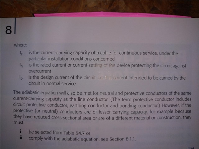

If we take say a circuit wired in 1mm cable, protected by a suitable device, lets say a Type C 6A 60898. By selection from 54.7 we can use a 1mm cpc. From the design guide it is stated that if the current carrying capacity of the protective conductor is the same as the line conductor then the adiabatic equation will be satisfied (so long as the circuit has been designed for protection against overload) but if it is of reduced current capacity then we have to either select (54.7) or calculate (adiabatic/verify energy let through) to check the conductor is suitably protected. As a 1mm cpc is the same as the line conductor apparently no issues...
But...
Table B7 of the onsite guide states that the minimum CPC size for a class 3 energy limiting device Type C 16A or less, at a sub 3kA fault level is 1.5mm2. Presumably because the A2S according to BSEN60898 is permitted to exceed the K2S2 of a 1mm conductor for this device. I've checked through a number of manufacturers energy let through charts and indeed for a 6A Type C breaker at certain fault current levels (some around 2.0kA) - the I2T does exceed the 13225 K2S2 for a 1mm conductor. Surely though this would apply to a line-neutral fault as well?

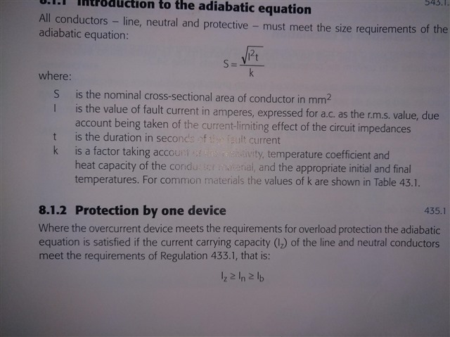

  •  Apologies for the confusion Graham thanks for coming back to me. I'm familiar with the difference between overload and fault. When I referenced the overload consideration I was referring to this in the design guide.
  •  followed by this... which seems to suggest that if the overcurrent protective device is ok for overload protection to a conductor correctly coordinated with the Iz of the conductor then the adiabatic equation will be satisfied for fault protection... which then takes me back to my original question of how that could be in the example if the fault current level were at a point where the K2S2 was less than the I2T of the device... because by selection it would all appear suitable unless the 1mm conductor happened to be the cpc of a 1.5mm cable. Hopefully that's a bit clearer!

  • Ah, I see now where you are coming from.
    I will have to think carefully about this, but my initial thought that there is a qualification which may be missing from Section 8.1.2 in EIDG, which is present in the regulation it refers to.
    The reality is that, Regulation 435.1 requires you to check adiabatic (Regulation 434.5.2) for the live conductors, regardless of whether they are protected for overload, and if you've already done that, a cpc of the same size is already protected.
    435.1 Protection afforded by one device
    A protective device providing protection against both overload current and fault current shall fulfil the requirements of the relevant regulations in Sections 433 and 434.
    Except as required by Regulation 434.4 or 434.5.2, where an overload protective device complying with Regulation 433.1 is to provide fault current protection and has a rated short-circuit breaking capacity not less than the value of the maximum prospective fault current at its point of installation, it may be assumed that the requirements of this section are satisfied as regards fault current protection of the conductors on the load side of that point.
    The validity of the assumption shall be checked, where there is doubt, for conductors in parallel and for certain types of circuit-breaker e.g. non-current-limiting types.
    So I think you are correct, it doesn't make sense, and it's not simply the case that conductors are protected against fault current just because the protective device protects them against overload current, and this is particularly true of circuit-breakers because of the transition between thermal and magnetic characteristic, or with non-current-limiting circuit-breakers.
    ... I will come back to this thread to confirm.
  • Thanks Graham. Having followed through those regulations it makes perfect sense as far as BS7671 goes... ie. that as you originally said the i2t can't exceed the k2s2 - so that does solve the discrepancy in my head regarding what is commonly taught practice and indeed the design guide is saying. Just checked the most up to date design guide and again under fault protection the same statement is made with no visible qualification to it.
    David whilst I appreciate we might be talking about an unlikely event - nonetheless BS7671 doesn't really permit us to make that decision as far as I can tell for a circuit unless we can call into effect 434.3 which might be a bit of an ask in terms of general compliance when designing a circuit. I appreciate that there is the real world and BS7671 land but even so.... Even as a hypothetical it's nice to clarify! Thanks anyway!
  • Just checked the most up to date design guide and again under fault protection the same statement is made with no visible qualification to it
    Thank you. I have already fed this discussion back, so if any clarification is required, it can be added.
