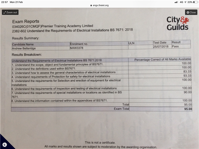

  • The point is Andy, the bar is far too low, and the schemes want to keep it that way because it is "cash for logos". Did you get 100% in the 18th edition exam? I thought not because I only know of two people who did out of hundreds! Strangely neither of these is what you know as an "Electrician"!
    The idea I have been discussing is that the teeth behind any scheme are far too lax, whatever NAPIT did at first, and those teeth need the law behind them, not some voluntary scheme membership. There is then that there is no real competition behind these schemes since Stroma was sold to NAPIT, you are paying at least £500 for what? Is it the logo on the van or is it competence, and being shown to be competent? If it is then they should offer a rock bottom guarantee that your work is entirely satisfactory, and they pay for correction, etc. if not. If you are not perfect you are thrown out of the scheme. They should specify exactly what each member (electrician) may do and what not. The QS scheme would be dead immediately, every man certified him/herself. Inspectors would need further qualifications, probably at least a TEng, and significant experience of the job under training.
    Your Facebook chaps would probably not stand much chance, as it would be illegal to employ an unregistered electrician. The question to answer is "do we need this given the risk to the public is extremely low" or should we dump the lot, no clubs, no notifications, and therefore lower prices?
  • @ David Stone
    You know I didn’t get 100% in my 18th Edition exam, because I posted a photo of my results sheet eight months ago in another discussion.
     RE: Videos of EICRs on Youtube
    An 18th Edition qualification doesn’t maketh the electrician, it’s just one small part of the required training.
