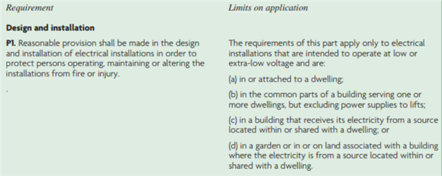

I'm trying to understand the scope of Part P as at the extra low voltage end of things it seems a bit contentious. Below is an extract from Approved Part P and it includes extra-low voltage. That raises some questions:
  1. Would 48V DC be in the scope of Part P as extra-low voltage appears to have no bottom end, just a top end at 50V AC and 120V DC? As an example, installing house wide lighting 'through the fabric of the building' run with a plug in 48V supply (plugged into a socket outlet).
  2. Lots of people are retrofitting under unit lights into their kitchens which are 12V. They have a plug in transformer, but in many cases the wires are then routed 'through the fabric of the building'. Why isn't this in the scope of Part P if a house wide extra-low voltage lighting system would be?
The second case could arguably be an 'electrical installation' too as although it is plugged in to an outlet, the wires and lights are fixed.

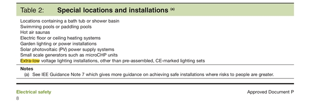

  • From the original version of Part P with the exclusion for pre-assembled CE-marked ELV lighting sets.
  • I read that a saying that extra-low voltage lighting is included. That list includes bathrooms ("locations containing a bath tub or shower basin") and so is a list of what is notifiable by virtue of its location.
    Interestingly, in the newer Part P it has dropped extra-low voltage lighting. So given it's not on the list it's not notifiable.

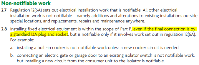

  • Well I should have read England's Part P cover to cover as there are actually some clauses that cover exactly the example I give:
    Even the lighting example I gave:
    The significant part is it is non-notifiable (unless in a special location) and so any competent DIYer could do the work.

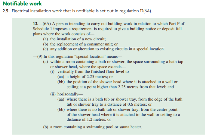

  • For the umpteenth time, this is Part P of the Building Regulations; The Law.
    It applies to ALL work in the locations stated.
    That's all there is; there is no more.
    The notification requirements are given in Regulation 12; also The Law.
    Approved Document P is merely a guide that someone has written; not the law.
    What is states has no effect on Part P nor Regulation 12.
    It is no more valid than anything NICEIC or anyone else has written.
    That Regulation 12 or Approved Document P do not include certain work does not mean Part P does not apply to that work.
