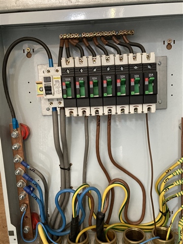

  • Not sure if you can make this out on this single phase installation. The Device is a 100A time delay 100mA RCD with a stated Im of 1000A. Upstream DNO 80A 1361 2B fuse.
    Ipf is circa 2KA on both LtoN and LtoE.
    My understanding of the IM value is that it relates to current in the live conductors and where a 100A RCD is used the upstream fuse should be one step down, in this case 80A.
    There is no mention of the IdeltaM value on the device. Any thoughts?
