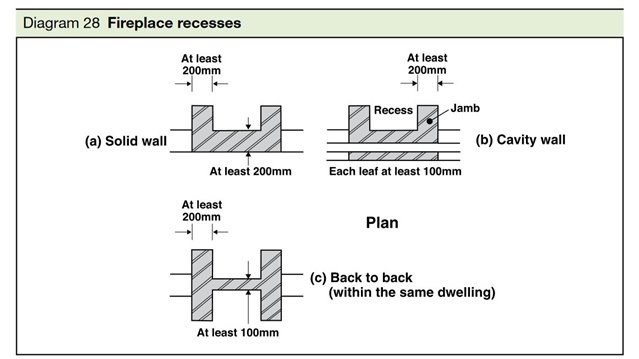

Looking to install an open fire with chimney grate etc.  On the other side of this install in the room behind there are sockets on the wall, (telephone and a couple of double sockets) direcdtly behind where the fire will be installed in the other room.  Are there any regulations around this?  Cannot find anything stating that this wouldn't be allowed.
  • So long as the wiring to those sockets is in the other side of the wall, and of course the wall construction is suitable for the fire place (brick or similar), it should be no issue. Any wall you can stick on wallpaper without it going brown (or smouldering !) will be fine for wiring.
    Do check though that the cables are not on the side the fire is going and then poked through. If need be they will need to be re-routed.

    Lots - but they're building regs - e.g. Approved Document J
    But as Mike says, get the arrangements around the fire right and everything else should be pretty normal.

    The boxes behind the sockets will reduce the thickness of the wall. I have no idea how thick the wall needs to be, but doubtless your registered installer will know. Wink

    Note that in Victorian properties the thickness of the back of fireplaces was often only one skin thick and the brickwork was usually poor as it would never be seen. Also products of combustion of solid fuel fires attacked the mortar between the bricks so great care needed when reusing such chimneys.

  • It seems that the principles of building construction have been forgotten. Chimneys are often built "back to back" as it makes the construction easier, but it is not because of temperature! Open fires are not just built against the bricks or whatever, they have a fireclay fireback, and then part J requires an impermeable lining to flue up the inside of the chimney to prevent combustion products from escaping into the rest of the building. You also need an air supply and a CO alarm. The old-fashioned large chimney spaces or inglenooks did not have the fire against the rear wall, thy had it contained by dogs or a basket, as building materials exposed to hot fires for long periods deteriorate badly.

  • From AD J looking at  either of the upper diagrams you do not want to be cutting into that 200mm or 100+100+cavity those thickneses mean that the far side of the wall does not get more than slightly warm. In effect on a solid plastered wall means OK to have wires and thin back boxes  into the plaster and render, but not if they are chiseled deep into the bricks/blocks. If need be the fireplace will need a thicker back so the fire is slightly further into the room, - but as has already been said, anyone who knows what they are doing will do this as a matter of course, or it won't get building regs sign off. If it is an under the radar job, then please follow the building regs even if an inspector never sees it.
