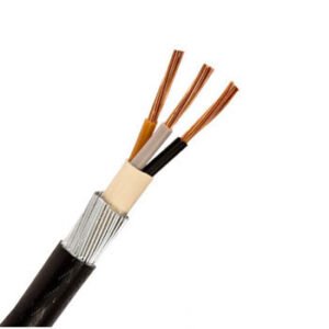

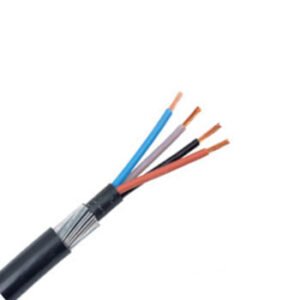

    Some folks  assumptions about colours for 3 phase colour SWA re-used for single phase may need more careful checking before termination. black is not always the earth ;-) But as above, other places have been doing it for years without blinking, and I am sure we can join them.
