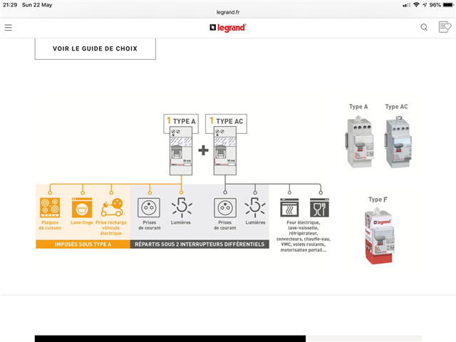

    I know I have previously posted links to the Legrand French website as well as others showing installation methods in Mainland Europe.
    In Mainland Europe Type AC RCDs are considered quite acceptable upfront of many circuits including socket and lighting circuits, the requirement is to have at least one Type A for circuits supplying equipment such as EVSE, washing machines and cooking hobs which have known problems with DC leakage.
    But the Brits being the Brits have to go for complete protection by Type A RCDs for all circuits.
    Don’t go blaming our European cousins for an apparent total ban on Type AC RCDs for socket and lighting circuits, because they do still use them.
    www.legrand.fr/.../que-doit-on-brancher-sur-un-interrupteur-differentiel-de-type-a
