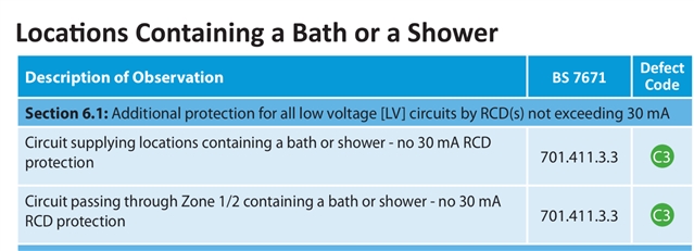

  • I am doing certificates and have pulled up the observation sheet for the EICR that I said about above, eighteen C3 observations eleven of which would be resolved by replacing the consumer units, but the landlord doesn't want to pay for unnecessary work by updating an old electrical installation, such as providing RCD protection for his tenants electric shower.
    Is that in spirit and intent of the legislation?
    After fourteen years and four copies of the Wiring Regulations, red, green, yellow, blue and brown along with another three C&G Wiring Regulations courses and exams, how come this is deemed acceptable when the legislation specifically refers to the 18th Edition?
