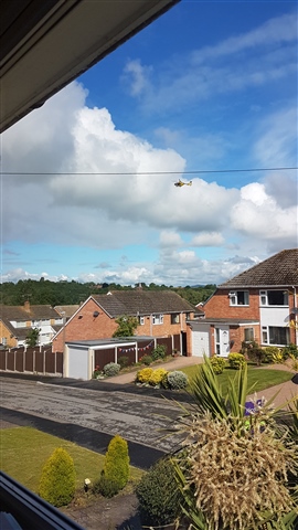

  • I am sat at my desk in a spare bedroom at home, Western Power are inspecting their network from a helicopter, now that's the way to do it.
