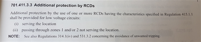

    The PRS Electrical Safety Working Group recommended that there should be guidance for landlords, tenants and electricians on the provision of RCD protection, the government has not provided this recommended guidance, so how can anyone really say if inspectors are trying to upsell by stating that an installation is unsatisfactory without RCD protection?
    It is all down to peoples interpretation of the legislation and the 18th Edition Wiring Regulations.
    If the legislation references the 18th Edition and the 18th Edition says "Shall" as it does in 701.411.3.3 why would I think it is only optional?

  • So @David Stone you are quite satisfied that a lack of 30 mA RCD for additional protection is acceptable under all circumstances in older rented homes, so a rented home with an electrical installation installed twenty years or more ago without any 30 mA RCD protection does not need any upgrading to provide 30 mA  RCD at all, despite the tenants using outdoor equipment such as a portable hot tub, lawnmowers and hedge cutters or whatever else they may to plug into sockets indoors or out, as well as using an electric shower and driving nails into walls to hang pictures.
    You are also satisfied that if stood in a coroners court you could justify signing an EICR to say the installation is safe to use and can explain a lack of 30 mA RCD protection is always a C3, never a C2?
    I know of one reference I could give to the court to back up those claims, but generally supporting guidance is very scant for that point of view.
