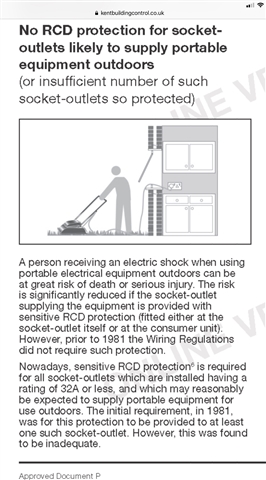

    Still there I think. The tricky bit comes because EICR isn't just a simple complies in every respect (pass), or doesn't comply in at least one respect (fail) - there's a need take a view on how serious each non-conformity is. Knowing how long ago the requirement was introduced is perhaps one handy yardstick for how acceptable its absence might be. If it was generally acceptable yesterday or last year it's probably considred less serious than something that hasn't been acceptable for half a century.
    Apparently the first requirement for 30 mA RCD Supplementary Protection in a TN earthed installation was the provision of a 30 mA protected socket for outdoor use in 1981.
    Sounds about right - usually achieved with one RCD socket marked 'For Equipment Outdoors' (if it was met at all). The requirement for 30mA RCDs for sockets in general (for indoor equipment, or indeed for bathroom circuits) is much much more recent. Most guidance AFAIK aligns with that - C2 for no 30mA RCD protection for sockets likely to be used for equipment outdoors, C3 in other cases. Likewise C3 for lack of RCD additional protection for bathroom circuits if supplementary bonding is OK, C2 if it isn't.

    It wasn’t long before the electricians started fitting Memara 2000 consumer units with a two module 30 mA RCBO for the sockets, which was a huge improvement however there was often a single socket built into the cooker control switch which did not have RCD protection, I coded several of these as a C2 whilst undertaking landlords EICRs because the tenants do open the kitchen window and plug in lawn mowers and other outdoor equipment, just like in the diagram in the Part P document.
