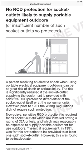

  • Apparently the first requirement for 30 mA RCD Supplementary Protection in a TN earthed installation was the provision of a 30 mA protected socket for outdoor use in 1981.
    If that is true don’t you find it rather surprising that some people are still saying that such a socket is still not required forty one years later?
    www.kentbuildingcontrol.co.uk/.../approved-document-p-2006.pdf
