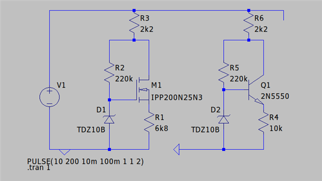

  • yes - given your full load current is u to 50% of the limit, you will almost certainly need to limit, ether as a direct current limit at 150V, - some modern transistors are good enough for this,
    a couple of options of that kind of thing there any old 10V zener and HV transistor would do. can be installed in series hi-side or lo-side.

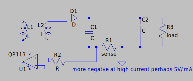

    or by sensing and folding back the drive smartish,  if the transformer is double wound you can sense in the groundy side but watch what is referenced and decoupled  to what, and note that the feedback voltage goes more negative as load increases.
    we use this latter for EHT supplies  100kV plus where there is no chance of a series limiter. When the sense voltage goes negative the HV has been pulled down to hard... There are a few extra components to protect the 'op-amp' as well.
    Ideas only, I have no idea of your application or what is really sensible in your specific case.
    If there are no other loads you could limit maybe just  on primary current.
