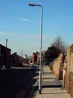

I am concerned about exposed-conductive-parts and extraneous-conductive-parts and bonding. If a metal road drain cover is located next to, and in reach of a metal street light column, should the two be bonded together?

    Not for LV installations. It might be different in special circumstances if we are considering HV installations (BS EN 50522/BS EN 61936-1) or considering rail traction supplies.
    In BS 7671, Reg 714.411.3.1.2 covers this precise scenario.
  • Only in Britain. The rest of the planet might paint the lamp post, but the thing most likely by about 3 orders of magnitude to do you lethal injury, or just any injury, is a car. And the problem is kinetic energy, not electrical.

  • Only if the gulley is inside a building...

    Well, within road tunnels, if the drainage system gulleys and pipes (and those of other services) are metal, you will often find those bonded in various places to the electrical services ... multiple times if there are a number of load-centres, e.g. shafts, but unless there's metal-metal contact between the metal drainage pipes and grid iron, probably the grid iron wouldn't be bonded.
