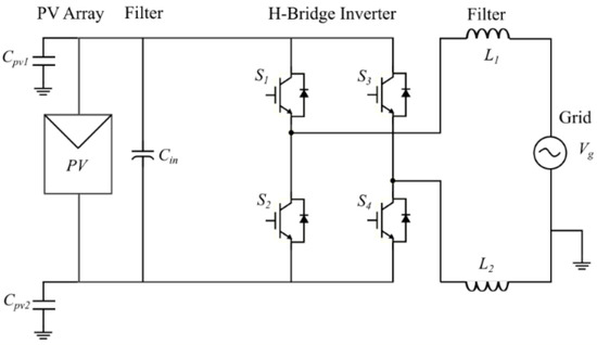

    On transformer-less inverters the strings alternate between being one way across the mains and then the other at 50Hz, with some wave shaping electronics and/ or with symmetric filtering - like this.  Note that  as the H bridge transistors switch  alternately, the mains live is routed to one side of the PV array or the other so the DC polarity is always correct.
    Simplified transformer-less inverter control electronics not shown - the side of the AC shown as  'earthy' is the neutral.
    The ones with  a high frequency transformer, rectifier and then 50Hz commutation may fully float the PV strings relative to earth or may earth one side of the DC  for EMC reasons.
    HF transformer kind - to left the DC from the panel is made into a supersonic square wave and transformed up or down and then rectified. The rest of the design is as per the transformer-less one above.
    Mike.
