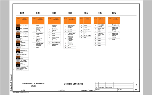

I'm wondering if could get a clear explanation or guidance on selectivity on an commercial/ industrial installation.

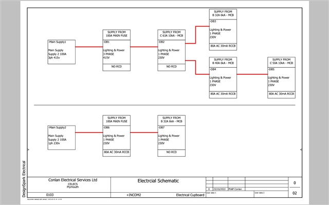

For example I have drawn out part of an installation below to help illustrate.
Is there a set process for determining if all MCB / RCD protection is adequate when moving from submain to submain?
  • RCDs in series wont reliably discriminate unless the upstream RCD is of a time delayed type. Try to avoid more than two RCDs in series and make certain that the upstream device is a time delayed type.
    MCBs in series wont reliably discriminate on short circuits, only on overloads. Avoid MCBs in series and use fuses for protecting upstream sub mains with MCBs reserved for final subcircuits..
    BS88 fuses in series will usually discriminate if of different ratings, and will almost always discriminate if TWO standard sizes apart.
    32 amp and 40 amp BS88 fuses in series will probably discriminate, 32 amp and 50 amp will almost certainly discriminate.

  • This is unlikely to be a satisfactory design. The top drawing is far from clear, and the circuit descriptions below do not fully match, and cascaded submains may well give you loop impedance problems as well as lack of discrimination. Cascaded RCDs are not a good idea as you have them, where does the Customer look for a trip? Your design may be easy to install, perhaps be a bit cheaper, but is far from good. I suggest a rethink, and as Broadgage says BS88s until you get to a final circuit breaker will give less problems for the customer, and discriminate better. The changing from type Bs to Cs is curious, why? A plan of the property would also be useful, and if the different parts have different occupiers, then it is even worse.
  •  Thanks for your response David, I should have stated from the start that this is an existing installation on a large commercial unit which has been split down into various workspaces (offices and art workshops for example). It is evident from the installation that submains have been added over time. I created the illustration above to try and give a picture of the site.
    The customer has requested a full inspection/ verification of the installation as its way out of date and he would like to start renting out the spaces and hopefully split them down further to individual metered units. The units currently don't have any tenants so there's barely any load on these boards, but as soon as space heaters are introduced tripping will occur for sure.
    I am proposing a new three phase supply the length of the property then branching from that. As the property is just shy of 100m over two floors they might not go for this proposal so the BS88 fuses maybe the alternative solution.
    In regards the RCDs I tested the furthest one and all upstream RCDs trip so clear they aren't effective.
    What further information would be required for a clear picture.
    Agreed - but I would add that the upstream RCD must also have a much higher residual current rating (e.g. min 3x the downstream rating) and be of a compatible type (e.g. a A type upstream of a AC type can't be expected to discriminate half-wave (rectified) residual currents).
