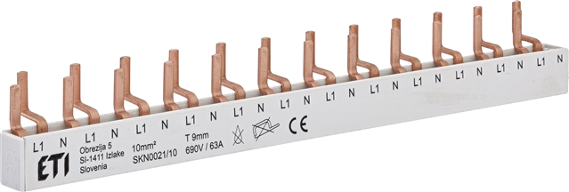

Just a quick question. What is the preferred option when fitting rcbo’s with the long supply neutral cable pre wired into them, do you cut them to desired length and ferrule them or leave them as is and try to coil the excess cable up in the consumer unit?

  • Hi Chris, It`s a twin busbar under the RCBOs that feeds both the L & N in on the RCBO so you just have L & N out (to the circuit)  to contend with and no Flying N leads to worry about. Those busbars are pretty close together and separated by a bit of plastic
  • ebee, thank you. I shall be interested to have a good look at the Schneider DBs which offer "wireless" RCBOs. Clearly, they are easier to install, but even without trimming the cable, installing the N cable is hardly onerous.
