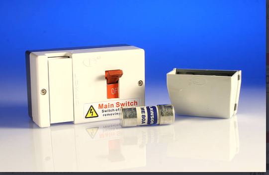

    KMF type switchfuses have been used for donkey's years to supply complete installations - including some with night storage heaters, which are probably as bad if not worse than EVs -  without any problems that I have heard of.

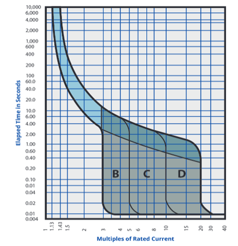

    The curve type (B,C,D) doesn't make much difference at all to the overload behaviour of an MCB - the thermal response is normally the same - the difference is just the point where the 'instantaneous' magnetic trip takes over. E.g.

    Lawson say their 63A BS 88-3 (BS 1361 as was) fuses dissipate between 4 and 5W (https://www.lawsonfuses.com/app/uploads/2021/09/ME-MF-Datasheets.pdf)

    Given metal enclosures are a bad idea due to open pen issues I am going to need to go down the path of individual fused switches using something like this. With everything contained in a meter box providing plenty of space for heat dissipation.
