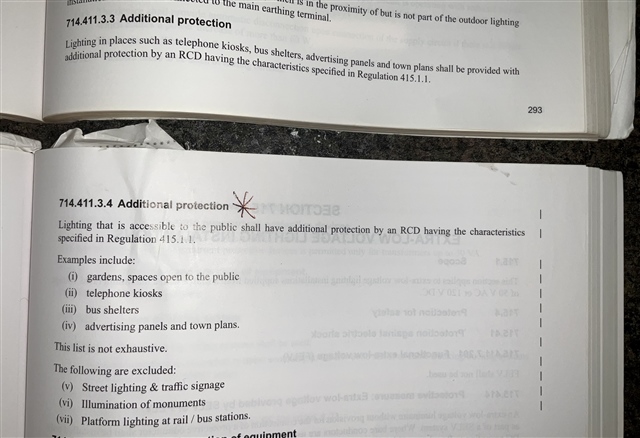

  • There is nothing to say that the RCD requirement depends on the height of the light source
    But it is dependent on the light being "accessible to the public" - my point is that if it's umpteen metres up in the air, it's not accessible to the public.
  •    said “Presumably intended to be interpreted as the light fitting itself is accessible, as distinct from the column that's supporting it. So perhaps doesn't apply in this particular case (unless the column is unusually short). The would keep it consistent with the listed exclusions - which includes street lighting.”.
    714.411.2.201 is a height specific requirement, light sources less than 2.800 metres have to be enclosed.
    714.1 Scope specifically states that sporting areas and flood lights are within scope.
    There is nothing to say that the RCD requirement depends on the height of the light source and the tennis court flood lights are within scope, so as an absolute minimum the lack of 30 mA RCD protection is a C3 and definitely cannot be ignored.
  • Lighting that is accessible to the public shall have additional protection by an RCD having the characteristics specified in Regulation 415.1.1.

  • Section 714
    Outdoor lighting installations
    714.411.3.4 Additional protection
    My understanding is the impetus behind the introduction of this regulation, in amongst others, was the incident in a pub garden resulting in the death of a child.
