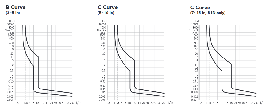

    Without knowing the exact breaker part no, this may be about right - 'US web data for noark Din Rail breakers
    Unlike much European data, they give curves that go far enough into overload to really show the time limiting of the mechanism. For the 'C' type, a factor of 20 in current gets you from about 10msec to about 5msec.

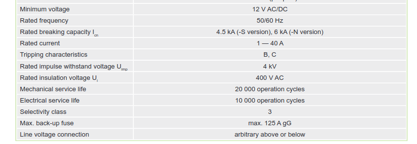

    Edit readng back up the thread, and now knowning the part no (oops) here is the datashet
    one sees the 6kA is an ICN (so will break, may not survive) and then further down the line
    "max back-up fuse 125A gG" so there is already a reliance on upstream time / energy limiting to achieve the 6kA level.

    "max back-up fuse 125A gG" so there is already a reliance on upstream limiting at the 6ka level.
    But that's the breaker, not the dimmer ... therefore, if it were that simple, the dimmer manufacturer would quote an Icc value ... unless they have not considered it? The breaker in the dimmer might be able to take it, but can the rest of the dimmer?
    In this particular case, unless the assembly (dimmer) manufacturer is willing to declare an Icc value, along with an appropriate protective device upstream, I'm not sure this goes anywhere sensible, as far as BS 7671 goes?

    Also it is a bit naughty of Chint / Noark to declare their devices as 6kA and then hide the equivalent  of " but only when backed up by 125Gg or smaller fuse" about 2/3 of the way down the datasheet !!!
    To me that  is an admission that even if the supply pssc had measured as 5.9 kA, an upstream fuse is required somewhere in any case, to operate and give non destructive coverage of the full range of fault currents. I presume without it the breaker de-latches but is then damaged beyond further use. I'd like to hope that flames don't shoot out the front but you never know.
    And that small but key detail about the essential fuse really ought to be copied into in the dimmer makers instructions too.

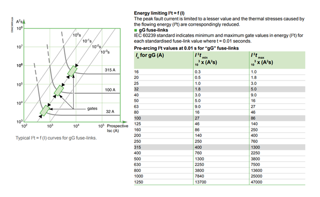

    Is one interpretation of the max back-up fuse statement on the data sheet that there must be an upstream protective device that has no greater energy let-through than a 125A Gg fuse, as of course in many instances you may not see a fuse until you get as far as the supplier's intake but there could be a series of MCCBs, MCB,s or other devices in a typical installation.
    That Gg fuse let-through looks to be around 1.7 x 105 A2s.  The let-through of the currently specified upstream MCB on a 9kA fault current is 1.2 x 105 A2s so would that be compatible (purely from the perspective of the MCBs - we'd still need something from the manufacturer about the rest of the dimmer though - but it is fundamentally a metal box?

  • If I'm reading this correctly then the I2t value for gG fuses flattens out at high prospective fault currents with a maximum of 140 A2s for a 125A fuse.
    So I might interpret the manual of the Noark MCBs to mean:
    Icn = 6kA
    Icc = Infinity kA (in practice limited by the rated breaking capacity of the fuse)
  • I think it's 140,000 A2s but your observation on the flattening out of the energy let-through is correct.
    The Icc statement made could be correct, but we would really need that set out by the manufacturer to be able to rely on it.
