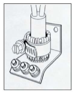

    Some of the things intended for terminating SWA in street lighting bare more of a resemblance to a jubilee clip and a short length of pipe than anything with o-rings in it... e.g. https://www.powerandcables.com/wp-content/uploads/2019/02/Central-Earth-Terminal-CET-for-Steel-Wire-Armour-SWA-Cable-Termination-of-Street-Lighting-Cables.pdf

  • Nice to see them on one page with the glands. Something like that is common on the continent (well Germany at least) for armoured or braided cables as well.
    Oddly if we saw one of those, in a domestic situation like a meter box or a supply to a garage CU we'd have a fit, as the single insulated splayed cores are not inside anything and are accessible .
    However, given that some sparks don't seem able to use glands with the right size star washers , perhaps we should actually encourage more of this sort of thing rather than the current attitude of  'waste some copper, use a CPC core and assume the armour may not be really earthed' which accepts a compromise of the ADS.
