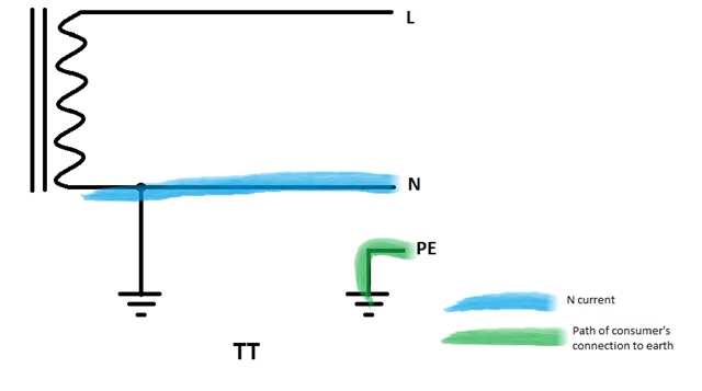

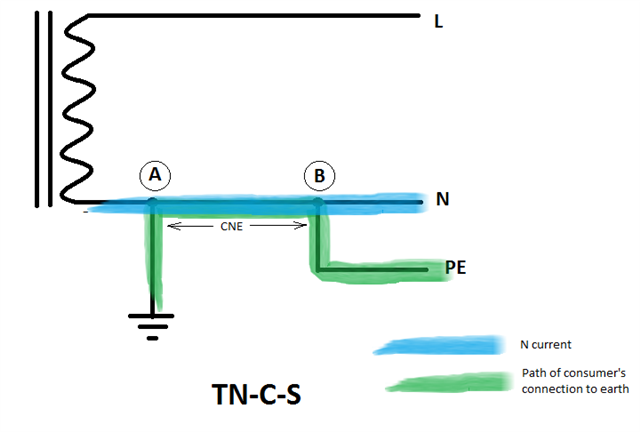

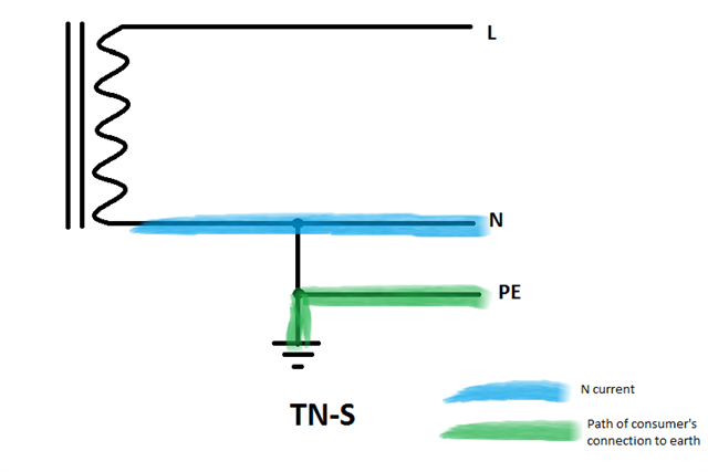

    Down that train of thought lie dragons I fear. This is the trouble of thinking in terms of earth fault loops - follow that logic and even TT should be considered TN-C in part - which cannot have been the original intention. If rather you think in terms of the path the installation has to Earth (which I think is the key issue when worrying about what can result in exposed-conductive-parts attaining a hazardous voltage relative to Earth).
    Consider...
    I think it becomes much clearer that only in a true TN-C-S system can the N current have any effect on the potential on exposed-conductive-parts, or a broken N result in earthed parts becoming live.
  • I think it becomes much clearer that only in a true TN-C-S system can the N current have any effect on the potential on exposed-conductive-parts, or a broken N result in earthed parts becoming live.
    N currents having effect on touch-voltages is a good reason why TN-C-S-c-...-s is a problem.
