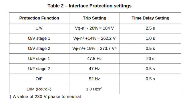

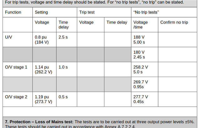

  • I suppose it wouldn't be against the letter of G98/99 to disconnect ordinary loads in a shorter times, especially for larger over-voltages (if leaving any embedded generation connected to the grid) - so I could still use a faster disconnection time to provide some protection to more sensitive loads,
    Maybe not in the spirit of keeping the grid stable, but larger over-voltages I suspect are more likely due to a local LV faults rather than a wider grid situation - something approaching 400V L-N as a result of a broken PEN in LV distribution system seems much more likely than 400V appearing due to the HV network running at 170% normal voltage (where there are no distributed Ns to break or star connected loads, that might have produced similar a condition to a LV broken N). And disconnection due to a local LV fault is hardly going to affect wider grid stability.

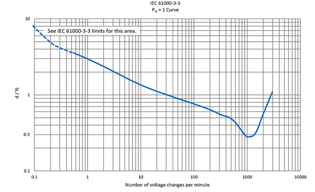

    Flicker 61000-3-3 is generally stepped voltage changes of less than 10%, and the test levels of the fluctuations are a lot less if if repeated  more than a few times per minute.
    Y axis, "d" is the voltage droop or uptick, 10%, 1% or whatever, and the frequency in events per minute is the X axis.

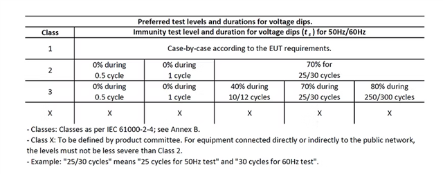

    Dips however are allowed to be quite severe, to 70% of mains voltage for up to 25 cycles at a time on a 50Hz system,
    In summary, nothing in an EMC test that includes all the possibly applicable IEC 61000 tests, verifies or assures any protection against significantly out of spec over-voltages (say 300v plus) on the mains that persist for more than,  at best, just under a millisecond, and for most domestic gear, probably more like 50 microseconds..
