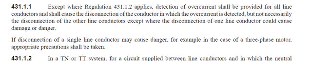

Could you please confirm whether clause 431.1.1 (iii) in BS 7671 is accurate and up to date?

  • BS 7671:2018+A2:2022+A3+2023 is the latest version of the standard.
    In the latest version, Regulation 431.1.1 does not have an indent (iii):
    Do you mean Regulation 433.1.1?

  • Sorry, please read it as 433.1.1
  • Thank you, in that case, the following answer I gave is relevant:

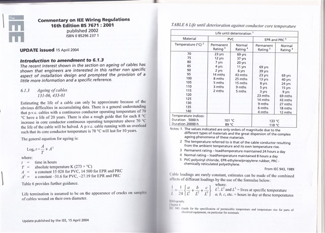

    It need not be quite as imprecise as it at first seems; although it is well hidden. Once can look at the adabatic curves of cable current handling, and the constant current ratings and look at the intersection. The answer is that the time for a cable to reach equilibrium in free air case for most common domestic cables is a few minutes.
    The second aspect is my how much the temperature rating of a cable can be exceeded, and what impact this has on the life of the insulation.
    You  can drop an offcut of cable into your mates cup of tea, and despite being well over 70c, the cable does not melt away like butter, it just gets a bit extra flexible.
    While it has now disappeared from the IET website, way back in 2004. it contained  this table . While assuming all PVC is created equal is rather dodgy, it does allow some estimation of the life shortening effect of overheating - and as temperature rise is generally proportional to the square of current, also tolerance to overloads (a current increase of 1.41 times will at worst double the temperature rise, perhaps less where convection cooling occurs and air moves faster with rising temperature). In summary a  hour or two at up to  perhaps 110C for a cable designed for operation of many decades at 70C is not likely to hurt it.
    The corollary, is that by designing things that run cool, they will probably outlive the building, let alone the installer.
    regards Mike.
